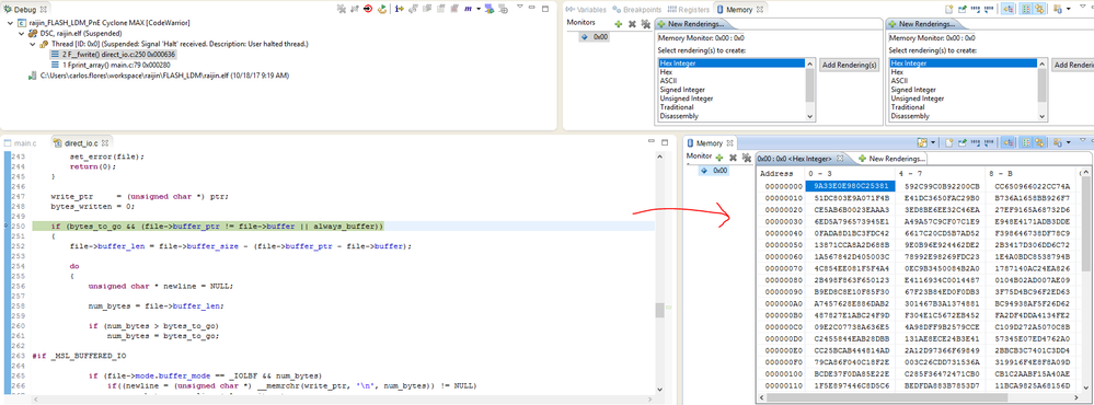

carlosglez
Hi Zhang,
   I'm now a this point: Already attach to the board and see data on the memory.

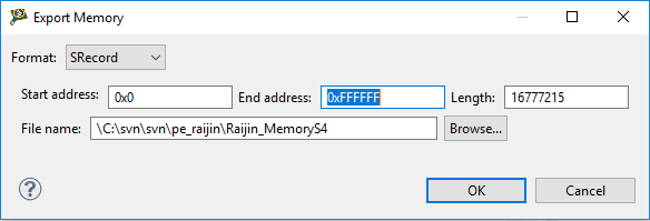

  Export the memory data from address 0x0 to 0xFFFFFF (Not sure what space of memory I should export but that's the biggest length it lets me).
After that, i got the following file:

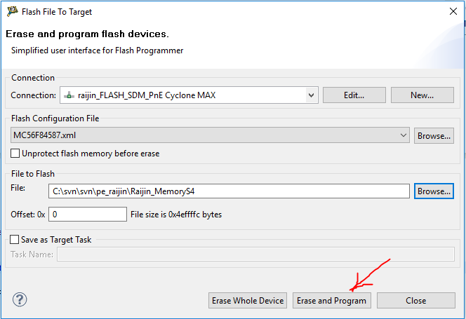

BUT! My trouble now is that when I dowload this file to a different board it doesn't work as the original board. I connected the new board and select my just exported file with the Flash File to Target option:
The board programed just dont do anything.

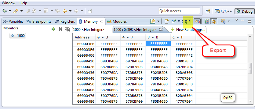

ZhangJennie
Hi Carlos.
you can extract memory data via debugger export button:
then save range of data in a file.

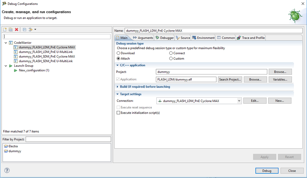

I would like to recommend create a new “dummy” project for your MCU derivative.
After that press small triangle at debug button and select Debug Configuration.
Here select Attach instead of Download.
 That should manage, that debugger will try to connect MCU without MCU reset and code loading.

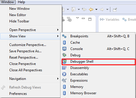

When connection will successful, you may open Debugger Shell
After that you may use mem, fl::dump or save commands for reading flash content (no experience on my side with that).
