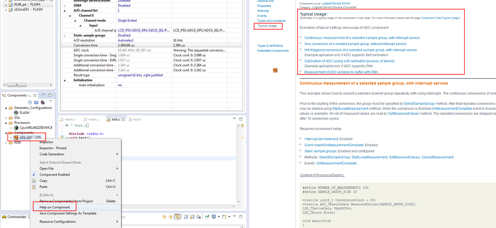

Hi there folks, I'm from Brazil and recently I bought this MCU FRDM-KL46Z  256 Kinetis L and I'm having some troubles with it. First the ball, is CodeWarrior the best IDE to program this board ? Second, It's my first time programming on Codewarrior IDE, and I know nothing how to create the code, despite of I programming C language, but I dont know the functions that work on the board. How can I know them ? What is it Processor Expert? I tried to use it but even that is pretty simple, I couldn't do this work on the board. Someone here could help me please ? I just want to know the steps from create the project and programming, to compile and debugging.

Hello Satos,
(1) There also have an IDE KDS ,  its free , and in the future, all of the support of the kinetis will design on  KDS .
you can download it here :
https://freescale.flexnetoperations.com/control/frse/product?entitlementId=123588587&lineNum=1&authC...
(2) On CW, create and build project you can refer to :   ..\ Freescale\CW MCU v10.6\MCU\Help\Quick_Start_for_Microcontrollers.pdf
and  "Freescale\CW MCU v10.6\MCU\Help\PDF\AN4902.pdf"
About PE, you can refer to : \Freescale\CW MCU v10.6\MCU\Help\PDF\ProcessorExpertHelp.pdf
(3) About example , for example , about the ADC ,after you create a project ,add ADC component , then you can refer to the "Typical Usage"
of help on component : (CW and KDS all have )
If you still have any question , please contact us !
Hope it helps
Alice
