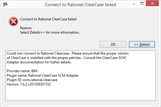

I'm using CW10.6 version for my TPMS Development, I have lots of source files to maintain, so I want to use the clear case version control for ChekIn and CheckOut function and all other functions for organize my project.
I have searched online but I'm not getting the proper guidance to plugin the clear case. If anyone has already working environment please share a document for a plugin ClearCase or any other related documents.
I have found the document for the CW10.3, I have followed the guidance at end of the process connect error, see the below figure:
I don't have any how to resolve this issue, this will be very grateful if anyone helps me on this. Thanks in advance.

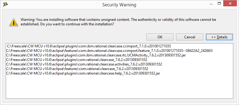

When Install the IBM Rational ClearCase SCM Adapter it  pop Up security Warning
Still, I have press OK to continue, Once Installation complete CW restarted,

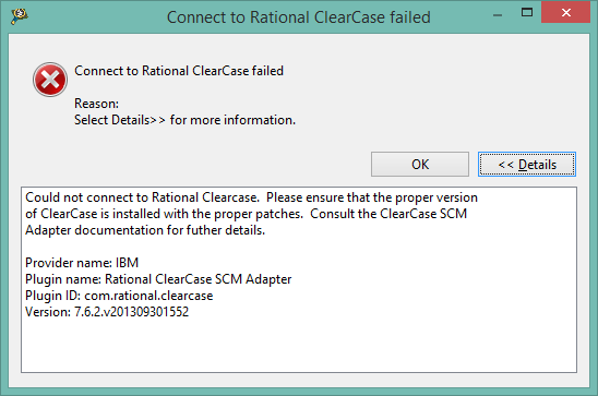

Once I selected Pop up below
I have the same problem still existing. Unluckily My system is Window 64Bit Operation system.

Hello sakthivel,
Thanks for your sharing.
I recommend you refer to the steps IBM provide to install :
IBM Rational ClearCase SCM Adapter (For Eclipse), Version 7.6.2.0 - United States
Also please pay attention your PC system, if 64 bit, there is a thread you need to have a look:
IBM About SCM Adapter support on 64 Bit operating Systems - United States
If still have problem when install it, I think you can also ask help from IBM support, they may know it more clearly.
Hope it helps
Alice
