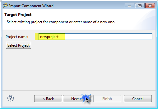

Hi Jerry,
You can import the component by going to the menu File > Import > Component Development Environment > Import Component/Interface:
Select an existing project or a new one to import the bean:
Select the Browse for folder option:
Select your bean file and click on Finish.
Hope it helps!
