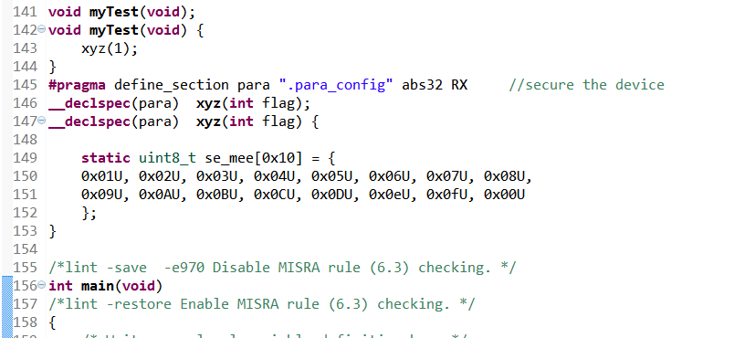

I would like to make a 1KB read-only memory segment in my Flash.
My chip is MK10DN512Z VLL10. It has PFLASH0 and PFLASH1 section, each having 256KB of data.
My lcf file looks like this:
and in my main file I did this:
then I called that myTest() function in my main file. But when I read from that memory segment, I see nothing is written to it!!!
Now once I do all this, I the xMAP file, I cannot see that my_factory sector is created (the pointer to linker file is generated only):
# .para_config
#>00004000          __PARACFG (linker command file)
Why is that?
The goal is to specify a read-only sector in my FLASH memory that my code can write to it only. Once the FW is up, no one can write to that segment.

Hello Mehdi:
I have some comments:
1- Your m_text and m_factory_params segments are overlapping, and they need to be separated. It is common to place configuration parameters at flash start or end.
2- You declare the array inside of a function. It is not necessary. Just declare the array alone.
3- In CPU processor expert build options, use "R" instead of "RX". The same for the section declaration.
4- As your array is in flash (read-only) use const instead of static.
5- In the main you put ".para_config". According to your lcf, this should be ".paraconfig".
5- You are declaring the array, but as it is not referenced from your code yet, the linker is being "smart" and ignoring that section. Use KEEP_SECTION to force the linker to place that section.
6- :smileyalert: Once you modify the linker file, you need to disable linker file generation from CPU processor expert component. It is in the "Build options" tab.

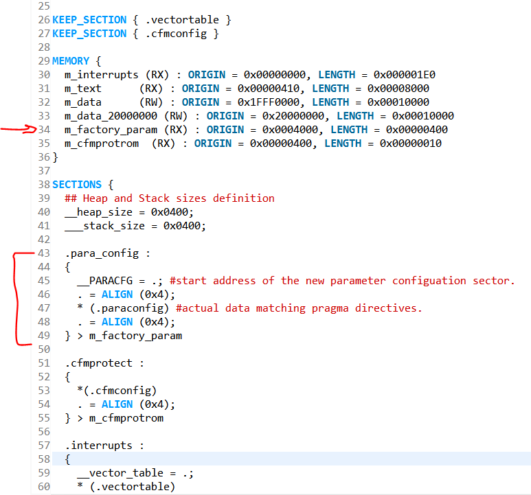

mehdikarimibiuk
Contributor V
Thank you Jorge,
Okay so this is what I am going to do:
1- since I will be implementing switch feature for FW update, I need PFLASH1 section for future use. So I am not touching that section.
2- As you suggested, I specify the last KB of my PFLASH0 as factory values. It starts at address 0x0040_0000.
3- I follow your fixes to my linker file and change RX to R. Once I adjust my linker file and main code, I printf those memory values.
linker file:
and below is my code:
#pragma define_section para ".paraconfig" abs32 R
__declspec(para)
  const uint8_t factory_values[3] = {
  0x01,
  0x02,
  0x03
/*lint -save  -e970 Disable MISRA rule (6.3) checking. */
int main(void)
/*lint -restore Enable MISRA rule (6.3) checking. */
  /* Write your local variable definition here */
  /*** Processor Expert internal initialization. DON'T REMOVE THIS CODE!!! ***/
  PE_low_level_init();
  /*** End of Processor Expert internal initialization.                    ***/
  /* Write your code here */
printf("factory param0 = 0x%x\n", IO_READ32(0x00040000));
printf("factory param1 = 0x%x\n", IO_READ32(0x00040001));
printf("factory param2 = 0x%x\n", IO_READ32(0x00040002));
printf("factory param3 = 0x%x\n", IO_READ32(0x00040003));
printf("factory param4 = 0x%x\n", IO_READ32(0x00040004));
the printf shows me:
factory param0 = 0x30201
factory param1 = 0xff000302
factory param2 = 0xffff0003
factory param3 = 0xffffff00
factory param4 = 0xffffffff
I would expect to see param0 to be 0xff030201, and the rest of registers to stay 'ff' all?
