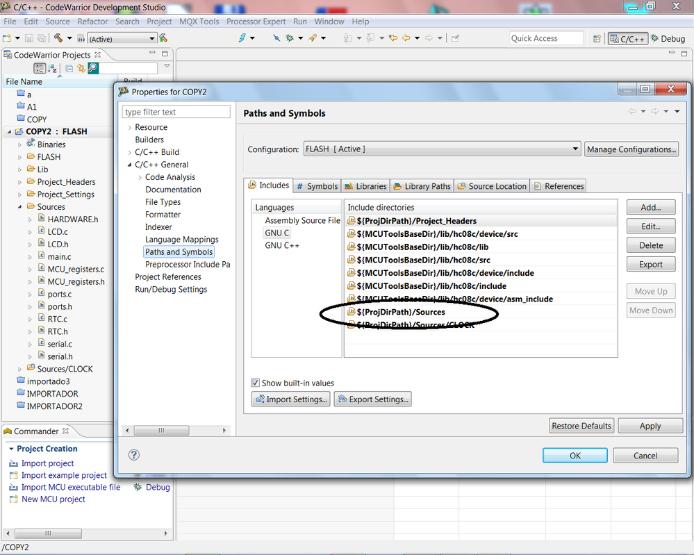

Hi atalbajracharya .
Right click in project in project view => properties.
Click includes tab .
Click add .
Write the directory with includes files . Example : ${ProjDirPath}/Sources .

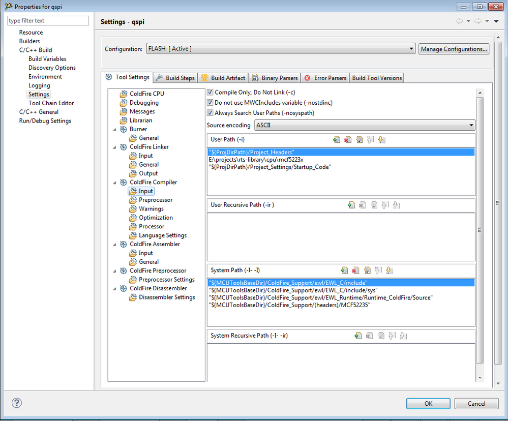

Hi Atal,
the compiler include paths are in C/C++ Build > Settings > ARM Ltd Windows GCC C Compiler > Directories (see screenshot attached).
Erich

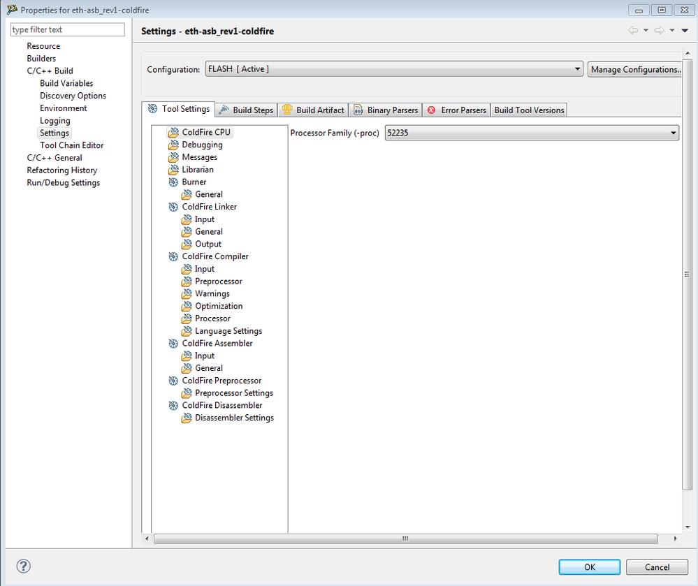

atalbajracharya
Hi, Erich
There is no directories option in the project properties window in my IDE. I have attached a screenshot.
Atal

BlackNight
Ah, I was (wrongly) assuming it is for ARM/Kinetis. For ColdFire it is under ColdFire Compiler > Input.

9,586 Views
atalbajracharya
I tried adding the include path in ColdFire Compiler > Input as you suggested but still, I am still getting an "Unresolved Inclusion" error, when I try to include a header file from that path. I have attached a screenshot.
Atal
