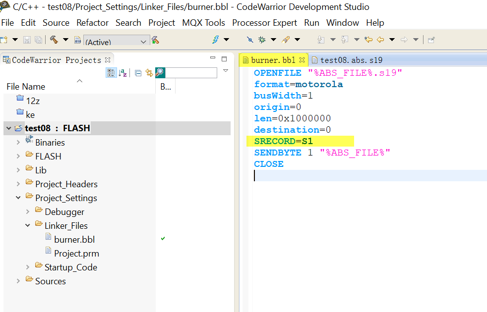

Codewarrior 10.4 for HCS08 micros by default generates an s19 file with 32-bit addresses for each record.  Is there a way change the Codewarrior 10 output to .s19 files with 16-bits (2-bytes) addresses?
We have some old roll-your-own tools that are expecting .s19 files in the 16-bit (i.e., 2-byte) address format, from the good ol' days of Codewarrior 6.  It's not to difficult to change them with SRecord (a highly recommended tool for your toolkit) but it's an extra step.  Something as flexible as Eclipse must have a switch that controls the output format hidden in there somewhere....

I had been using SRecord to correct the address width (a highly recommended tool to keep handy).  I was not sure whether burner.bbl was actually used by CW10.  A brief encounter with Build_Tool_Utilities.pdf seems to be stating that it is a utility to serially output a program file to a device programmer, however it seems it is, in fact, part of generating output.  As the "SRECORD=Sx" parameter works as advertised it will suit my needs very well.

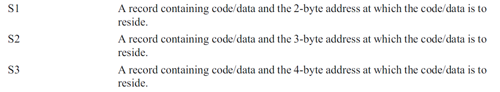

ZhangJennie
Hi Doug,
Different Srecords type are for different address length. for example:
Thus, if we need 2-byte address type, we need set srecord type as S1 in burner.bbl file
