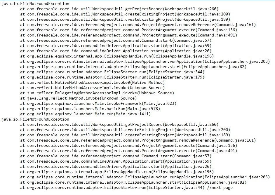

157873_157873.jpghelp1.jpgI have downloaded a project from a repository that refers to another project. I'd really like to build this project with Codewarrior 10.4's command line tools. However, the reference path in my .project file doesn't correspond to the location of the project it references, on my computer. I needed a command-line, programmatic way of changing the reference path to the correct location on my machine. So I tried

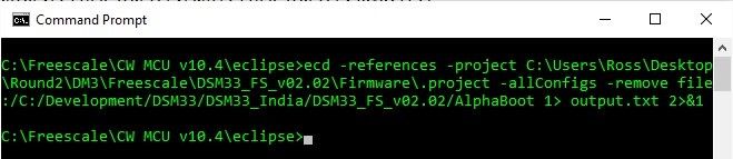

ecd -references -project project_pathName -allConfigs -remove wrongReferencePathName
with the intent of then running
ecd -references -project project_pathName -allConfigs -add correctReferencePathName
But the first command gave me a file not found error. So, it looks like I can only remove references to projects that actually exist on my system, and can't get rid of bogus references to projects that aren't even valid locations on my filesystem.

I tried multiple options for wrongReferencePathName. Above I tested "file:/C:/Development/DSM33/DSM33_India/DSM33_FS_v02.02/AlphaBoot", but I also tried "C:/Development/DSM33/DSM33_India/DSM33_FS_v02.02/AlphaBoot" and "C:\Users\Ross\Desktop\Round2\DM3\Freescale\DSM33_FS_v02.02\Firmware\.project".
They all produced the same error. The paths I'm trying don't exist in my filesystem--I have different paths to the referenced projects in my filesystem--so it kinda makes sense that I'm getting a fileNotFoundException. Maybe it's that the references tool is looking for a .project or .cproject file at the provided reference path and crashes out if none is found.

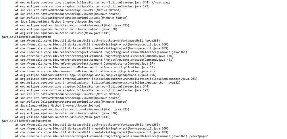

Here is the error output--not sure the full backtrace will be helpful
