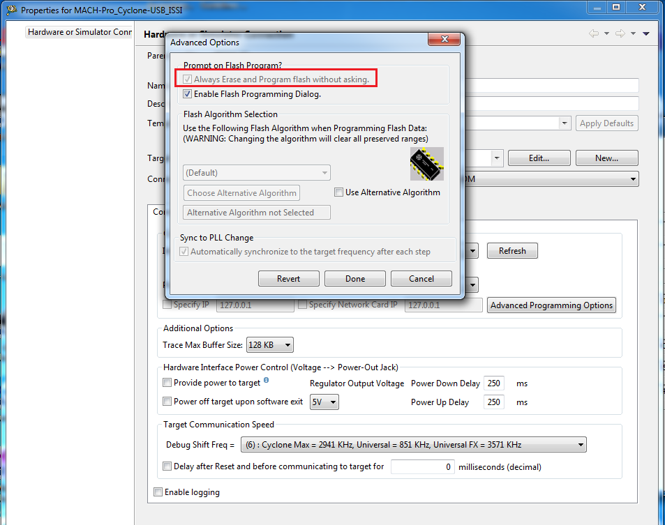

Hi there,
we just updated from 10.2 to 10.6 for a MCF5271 project and have noticed the following: when we download to RAM for debugging it always attempts to write to flash.  To update I created a new workspace and imported the 10.2 project into 10.6 without any errors.
I found this setting enabled in the Hardware Connection Advanced Programming Options: "Always Erase and Program flash without asking.", and I can't disable it:
I'm guessing this is the issue; I tried modifying the .launch and ReferencedRSESystems files but the values are overwritten by the IDE.  Any ideas?

OK, I've verified that we are loading our app into RAM, it's just hard to see with the IDE trying to write to Flash every time we want to debug from RAM.
We can reliably debug from RAM using (a single) hardware breakpoint.
However, when we try and work around this issue (a single hardware breakpoint) by using software breakpoints we are able to reach the software breakpoint once, but the next time we reach it we end up in the MQX (3.8) _int_unexpected_isr.  When I inspect the RAM memory where the software breakpoint is at program start-up compared to after the first breakpoint I don't see a difference and it matches the compiled code.

mjosborne
can we please get assistance with these issues.
We have upgraded to MQX 4.1 and we still have issues with our MCF5271 project using CW 10.6.
It seems fairly clear that there are two issues with CW 10.6 MCF5271 support (same project in CW 10.2 works fine) :
1. It always tries to program Flash (even when there is none), and this option (Always Erase and Program flash without asking) can't be disabled.
2. Software breakpoints don't work when instruction caching is enabled (generates illegal instruction exception).

mjosborne
These are still open issues for us:
i) How to disable the "Always Erase and Program flash without asking" option,
ii) How to fix the issue where CodeWarrior 10.6 software breakpoints cannot be used when instruction caching (MCF527x) is enabled.
We've been experiencing these issues since December and would like to resolve them as soon as possible!

mjosborne
We have updated to MQX 4 with CW 10.6 for our MCF5271 based project and are still seeing these issues.
Can someone please determine why the "Always Erase and Program flash without asking" option cannot be disabled, it really slows down the debugging process (when debugging we're running out of external RAM, so there's no Flash to program)?
