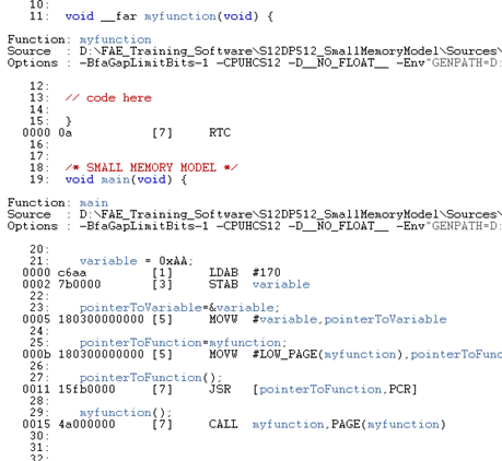

It's true that small memory model can keep code size small. But with small memory model Data and functions are accessed by default with 16 bit addresses. If we need to access other paged memory in small memory model, we usually use keyword __far to overcome this limit.
I don't familiar with Edward's method, but above is my method of accessing other page functions in small memory model.

__far is required to make PPAGE switched enterting and exiting from function in 0x8000. It is not required in small memory model and just burns additional bus cycles. If PPAGE stays constant (0xFE by default) then there's no difference executing small memory code at 0x4000, 0x8000 or 0xC000. Of course Robert could make all functions paged at 0x8000 loosing all speed benefits of small memory model.
