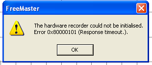

Hello everyone!
I have 3-Phase BLDC/PMSM Low-Voltage Motor Control Drive from Freescale and I uploaded it with sample program from producent. I used to it CodeWarrior 10.6.4. I used to it MC9S08MP16 daughter board. BLDC works well but I have problem with Freemaster application. I didn't change anything in the code and in it it was part for Freemaster too. When I want to show charts in Freemaster there is error:
Also some variables are highlighted red:
It shows on every charts, but main view when screen works properly. The problem is only with scopes. I'm new in using Freemaster and I don't know why it doesn't work. Please help me with this
problem.
Greetings,
Pawel

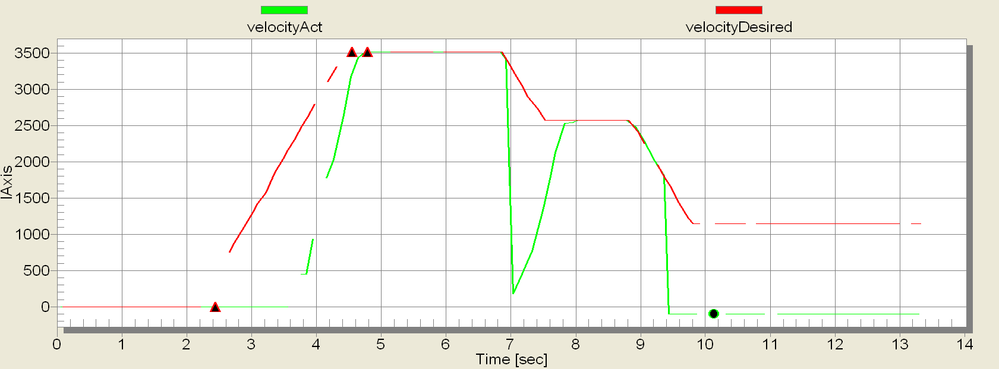

pawelniewiadoms
The recorder still doesn't work but I'm doing now charts with scope and it's working fine.
I don't know what are the triangles and circles appeared in my scope. Anyone knows?
Greetings.

ZhangJennie
hi,
first ,please check if you enabled FMSTR_USE_RECORDER in freemaster_cfg.h.
you can also refer these article for how to configure freemaster:
Tutorial: FreeMASTER Visualization and Run-Time Debugging | MCU on Eclipse
FreeMASTER Run-Time Debugging Tool|NXP
Hope this helps!
Jennie Zhang
3,145 Views
pawelniewiadoms
I checked freemaster_cfg.h library and I think everything is correct:
#define FMSTR_USE_RECORDER1   // enable/disable recorder support
#define FMSTR_MAX_REC_VARS8   // max. number of recorder variables (2..8)
#define FMSTR_REC_OWNBUFF 0   // use user-allocated rec. buffer (1=yes)
Unfortunately I didn't find anything on Freemaster Tutorial about my problem. Any other suggestions?
