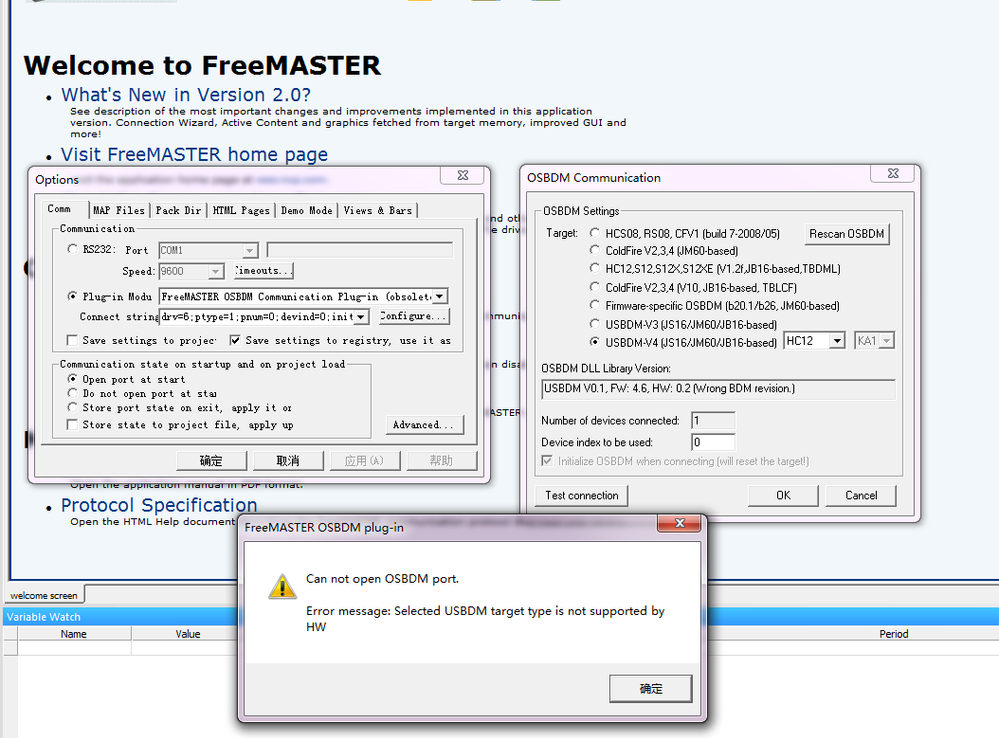

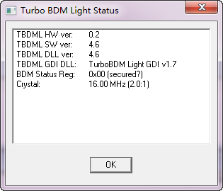

akawxt
hi Jaroslav!
I am a newer in FreeMaster(version:2.0),I have a problem:how can i connect my MC9S12XEP100 with the FreeMaster correctly by TBDML!this is my TBDML ,see the picture :
this is my settings in freemaster:
3,672 Views
