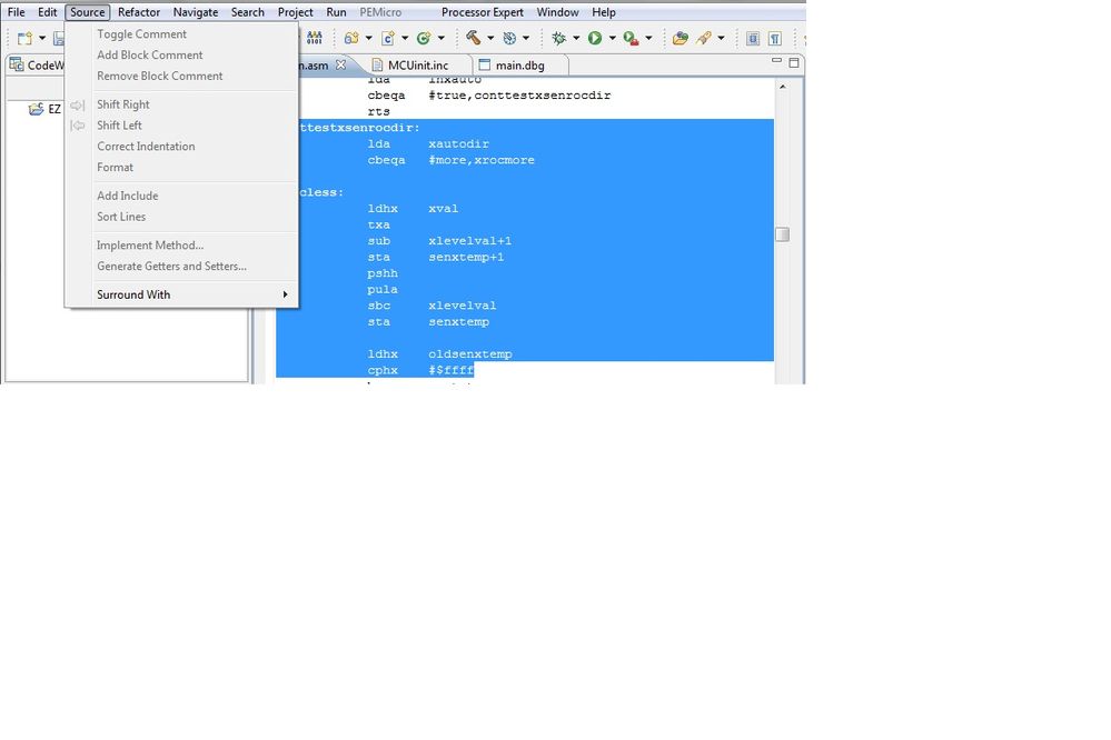

I have tried to select pieces of code and the menu doesnt offer me any selection under "Source" other than "Surround With" .. See image below

BlackNight
Hi Jeff,
I see: you are using assembly files.
Try the same with C/C++ files and you will see the difference.
Eclipse needs to parse the sources for the advanced options. And as every assembly language is different, assembly source files cannot be used with such advanced formatting features.
But normal edit commands like <shift>+<tab> of course are apply.
I hope this helps.

Yes Erich ... My original post said I program with assembler not C ... So .. no point in trying C and seeing what happens.
I have used many other assembler IDE's and they had formatting options or at the VERY least an option to comment out selected code.
I guess unless there is any other reply to this thread that for some reason formatting isnt possible with assembly files.
