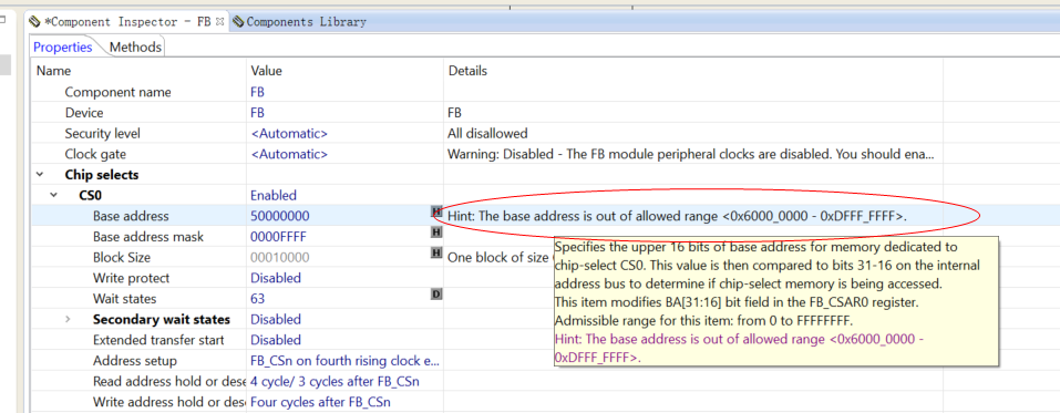

When using Processor Expert (PE) in a MK64FN1M0VLQ12 bare metal project within CodeWarrior 10.6, the FlexBus component/bean (Init_FB) doesn't allow me to point its Memory block 0 to 0x60000000.  It responds with the error "There is no access into memory from 0x60000000 to 0x60000001".  Is this a bug?

Hello Joe,

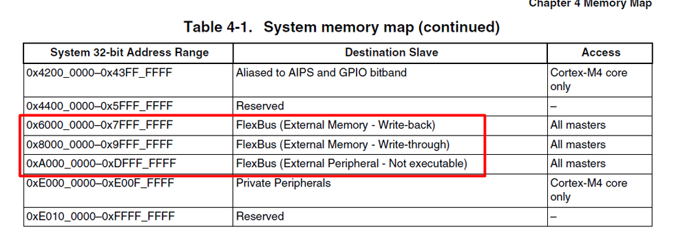

This is not a  bug . The Flexbus address allowed range is 0x6000 0000 - 0xDFFF FFFF .
Processor Expert reminder it , also the Reference Manual of chip MK64FN1M0VLQ12 show it :
Hope it helps,
TIC

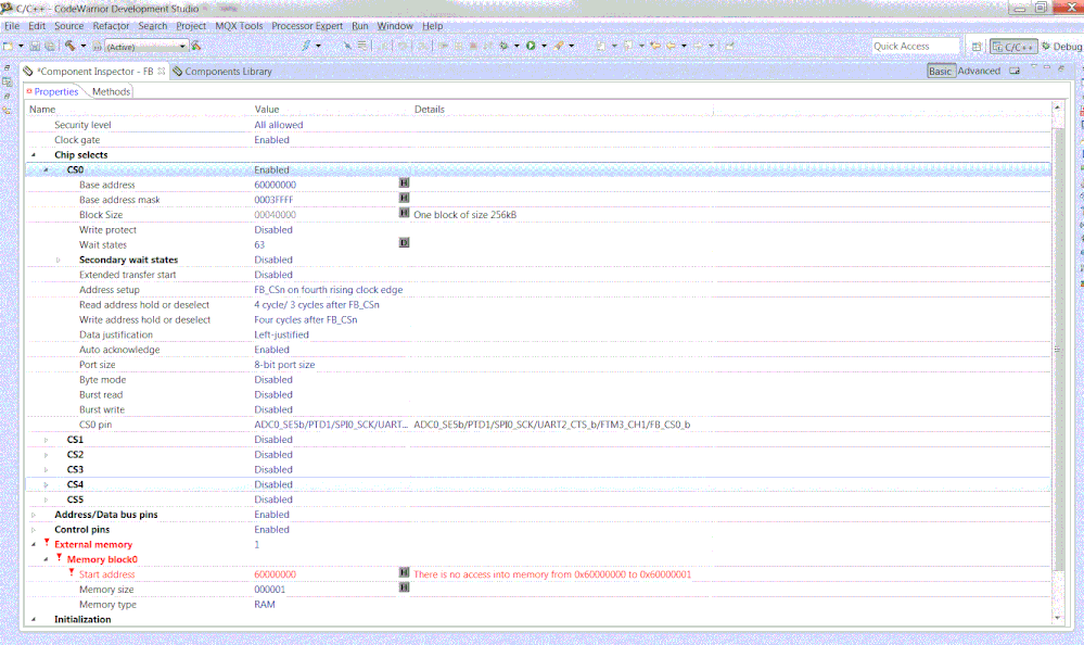

kackle123
I included a picture of the FlexBus (Init_FB) Processor Expert (PE) component:
To recreate the problem:
1) Create a new MK64FN1M0VLQ12 (LQFP 144-pin package) project with PE within CodeWarrior 10.6.
2) Add component Init_FB to its PE.
3) Populate the Init_FB's values in the same way shown in the picture above.
No start address that you enter is allowed.
