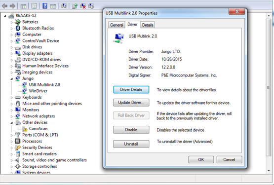

I am using CodeWarrior 10.6.4 with a P&E USB-ML-UNIVERSAL cable to connect to a Kinetis K60DN512VLL10.  Flash programming and debugging fail.  I have captured a diagnostic zip file.  I was using this on a different computer just fine, but I upgraded my computer and now the setup doesn't work.

If a sample project is not working, the problem could be linked to the Multilink or to the Board.
Does the 2 lights (blue and orange) on Multilink are lighted ?
To simplify I can say the blue is for the connection between PC and Multilink and orange for connection between the multilink and board.
Under Windows Device Manager the Mulilink 2.0 should be displayed
Multilink is a P&E interface.
There are some FAQs on P&E web site.
Please have a look to:

Hi Carrie,
This is my configuration:
    Win 7 64 bit
    CW for MCU V10.6.4 + Updates 5 & 6
    TWR-K60D100M (Based on K60DN512)
    Multilink Universal Rev B
With this configuration I've created an example with the project Wizard.
After to have build the project I can launch the debug session for Ram and Flash targets without problem.
Using the Flash file to Target , it's working fine too.
Can you try to create a sample project with the project Wizard ?

I have created a sample project but get the same errors when programming or debugging.
