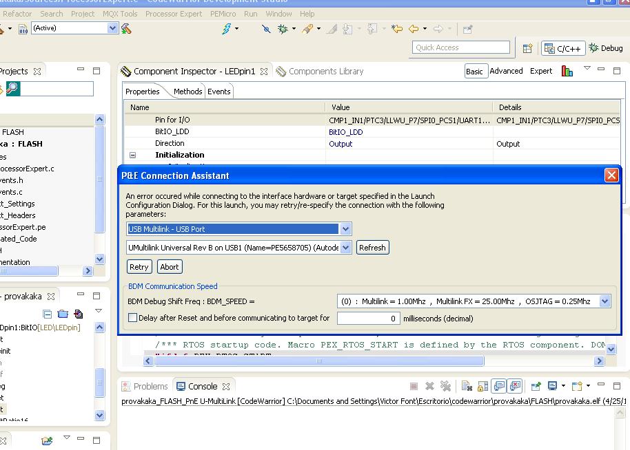

Hello
I am trying to Run a project using a MultiLink Universal. I tried to Run the project in several boards, some own boards and some Demoboards (FRDM-K20D50M) and in all the cases the problem is the same. I attach a Screenshot of the error that appears. In the case of the Demoboards if I program the boards using the OpenSDA the boards works properly.
Any solution?
Sergi Bisbe

Hi Sergi,
Based on following configuration:
      - Windows 7 32 bit
      - CW for MCU V10.6
      - TWR-K70F120M
      - interfaces: P&E Multilink Universal, JLink and OSBDM.
With the Project wizard I've created an application based on TWR-K70F120M (PK70FN1M0) for the 3 interfaces.
After to have build the project, I'm able to load and debug the application with all interfaces.
However to be running the OSBDM must be plugged (it will provide the power supply required for the board).
Attached you will find the project used.
Pascal
