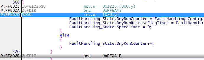

TLDR: under certain circumstances the increment operator (++) used on a 8bit uint compiles to inc.w and therefore the variable allocating the next byte in the memory gets incremented.

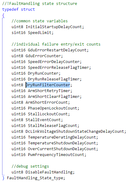

The structure containing the variables:

So, if I compile the code I get the following:
(test_var++ is also there, but it is in a different address)

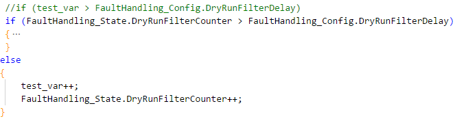

The reason because I do think this is a bug is, that if I switch the if statement to the one containing test_var
This is what I get:
(also, it does not need to jump in order to increment the second variable)
