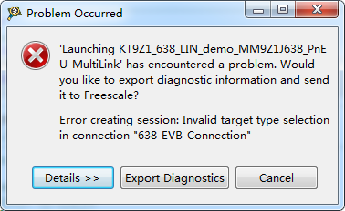

Error creating session: Invalid target type selection in connection "638-EVB-Connection"

Hi all,
I come across a problem when i run the project it occur this condition ,could you tell me the problem?
thank you

I never meet with that error message yet.
It seems, that there is probably some wrong setting in your connection settings.
Few recommendations:
Please clean your project and build again. Menu-Project-Clean…
If you use more than one PEmicro BDM interfaces (like OSBDM and Multilink Universal), please let just one connected to the PC.
Please check whether your connection settings are correct.
Menu-Run-Debug configuration-C/C++ application-Please check whether correct elf file is referenced
Menu-Run-Debug configuration-Target settings-Edit-Target-Edit-Please check whether correct Target type is selected.
Menu-Run-Debug configuration-Target settings-Edit-Please check BDM interface configuration and detected Port.
The debug connection settings are stored in ReferencedRSESystems.xml file in the root of your project.
The creating new target configuration is nicely described for example here:
https://mcuoneclipse.com/2012/04/30/flashing-with-a-button-and-a-magic-wand/
I hope it helps you.

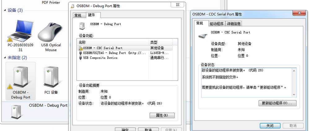

dws
Hi Radek,
Maybe I found the question as follows:
Dawei

RadekS
Hi Dewei,
Please try to download and install current PEmicro drivers:
P&E Hardware Interface Drivers, Version 12 (Win XP/Vista/7/8/10)  (9828 KB)
http://www.pemicro.com/downloads/download_file.cfm?download_id=53
The OSBDM and PEmicro Multilink BDM interfaces share the same ID. If you connect both interfaces, the Multilink BDM interface is typically preferred and OSBDM does not work correctly.
If you use KIT9Z1J638EVM board, please check S1 switch position per KIT9Z1J638EVM QSG (Figure 3. Switch S1 Settings):
http://www.nxp.com/assets/documents/data/en/quick-start-guide/KT9Z1J638QSG.pdf
