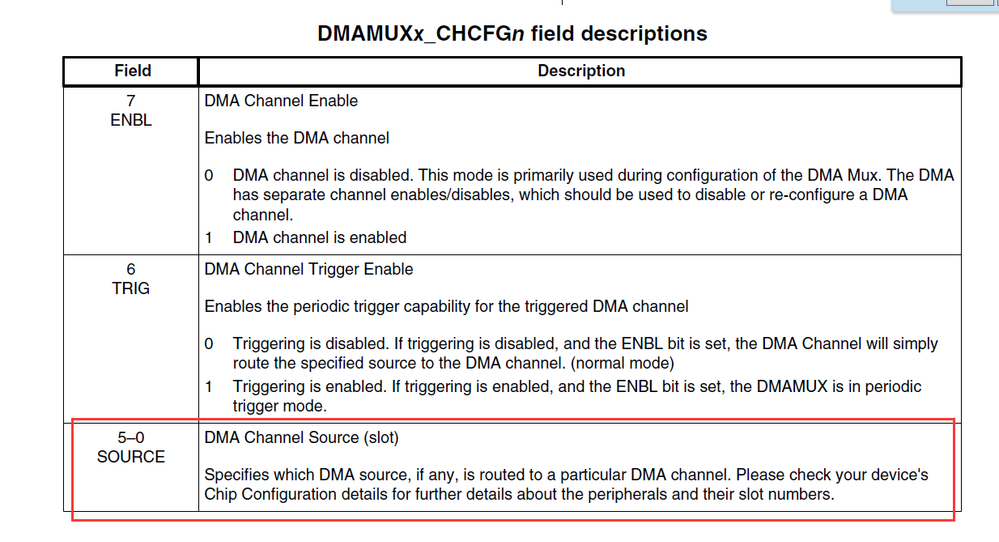

1) -  The DMA Source , please configure the  register of DMAMUXx_CHCFGn -> SOURCE :
About the source , please check the part of   3.3.9.1 DMA MUX request sources on RM.

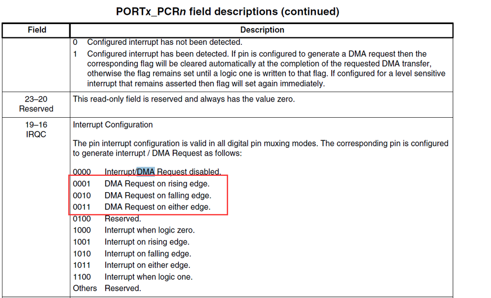

- Yes, you can use the gpio to trigger DMA , about how to trigger ( rising or falling edge) ,please check the PORTx_PCRn register on PORT part .

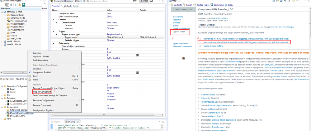

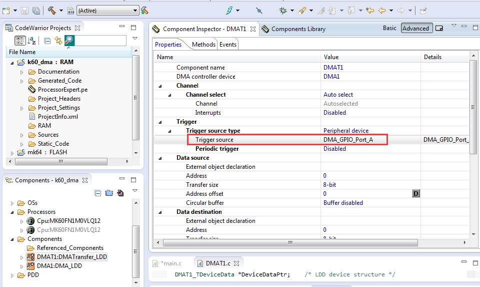

2)  There is a easy way to configure , create a Processor Expert project on CW, then add the component of
"DMATransfer_LDD" , on the configure view , you can choose the Trigger source :
Also there is a demo , DAC trigger DMA,  you can refer to :
