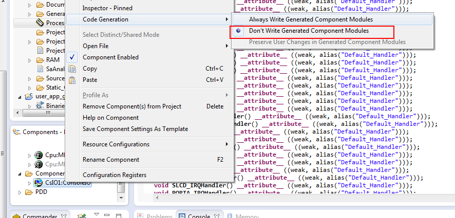

Hello Carlos,
- About "If I manually make some changes to the automatically generated code of MCUinit.c," , after you change the code ,
please select "Don't Write Generated Component Modules" , then after you build , the changed code won't disappear.
- About "If I make some changes to the configuration of the peripherals, the changes are not applied," , please tell me you use which CW,
and chip, use which component, initialize which part, then i will test it on my side .
Alice Yang

My CW is 10.1.
After posting the question, I found this user guide.​ It helped me understand better the difference between Device Initialization and Processor Expert.
I had created my project enabling Processor Expert. I started a new one, enabling this time Device Initialization, and now it works OK. I moved all my source files to the new project and the problem is solved.
About the options your mention, I don't even have that menu. Looks like I don't have Processor Expert installed, only Device Initialization. Anyway, my problem seems solved.
