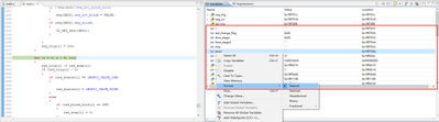

Debugging variables are garbled.To see the values, have to right click one by one,then click Format , click Hexadecimal, and change it to Hexadecimal.display as follows.Is this caused by a certain setting in encoding and where to fix it?Please help,thank you.

CodeWarrior eclipse is based on eclipse platform, the default variable view type is not hex. You can select all variables in variable window (ctrl+A) , set them as hex show together. It's easier

I don't have to see variables as hex type.I mean if I don't convert to hex format, I'll see nothing, or just garble (in the default view type).So is there a way to solve the problem of variable window displaying garbled characters in the default view type?

The variable default show in variables window is string. For example, if the variable is  0x6d, the default show in variables window is 'm'. see below
Only the value shown in ASCII table is visible, other values are "garbled" because they are not ASCII code. This is not a bug.

Hello Jennie,So there is any way to change the default display format? In setting or somewhere?Ctrl + A does not work well.After I execute Ctrl+ A,then right click,but don't show Format option.
