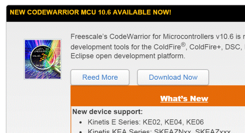

Plus the home page says "Reed More". Someone should fix that. Pretty sad.

3- Do you mean "Reed More" instead of "Read More" ?
      do you have a screen shot or info to help me to show it

3. Yes (and sorry for nitpicking):

Point 3 fixed.
      https://community.freescale.com/community/codewarrior/cw-mcu
