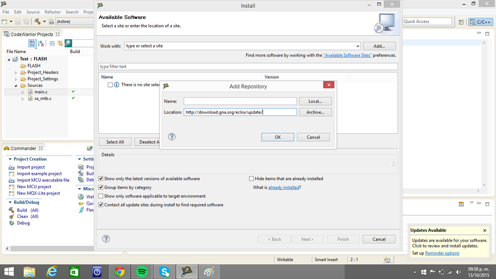

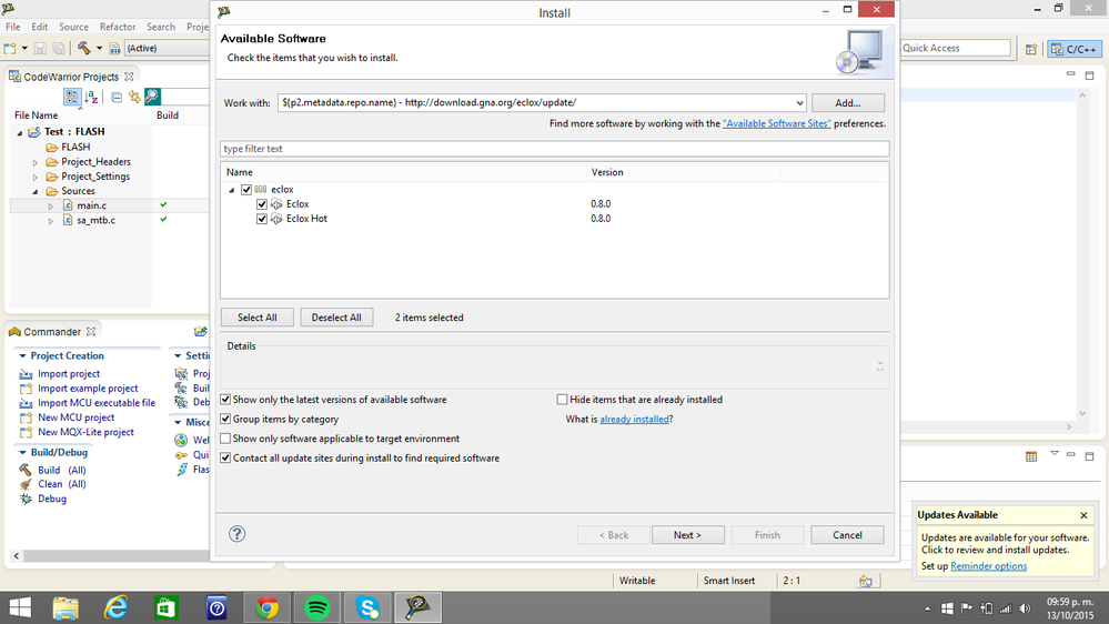

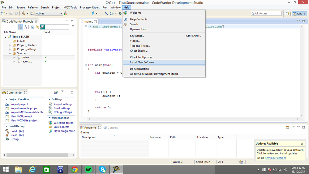

Hi everyone
i have a problem installing the app of doxygen(Doxygen is a compiler which generates documentation out of source files.)
After installing all of them, finally the Eclox Eclipse plugin: point Eclipse to the Ecloxupdate site:http://download.gna.org/eclox/update/86868_86868.pngerrores.png
i have to dowload the app

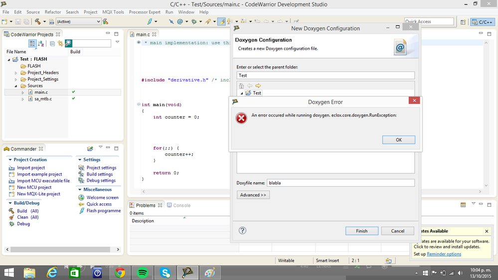

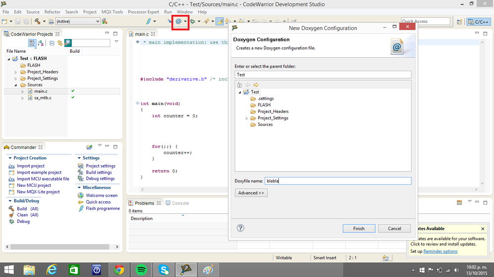

after to install all
i click in the app for doing documentation
the doxygen ask me for a doxyfile name,
when i click  finish this error display
this is my question which is the error?
i try to reinstall codewarrior and eclox app
any help would be good, thank you.
1,816 Views
Carlos_Mendoza
Hi Sebastian,
I'm not sure what could be causing this problem but please take a look to the following post created by our colleague Erich Styger, as you can see in the comments Shenzhen had the same issue and fixed it by creating the Doxyfile with Doxywizard and copied the Doxywizard into the project:
5 Best Eclipse Plugins: #1 (Eclox with Doxygen, Graphviz and Mscgen) | MCU on Eclipse
Hope it helps!
