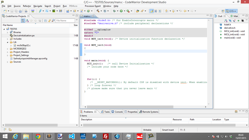

I'm tring to develope a simple project for the MC9S08QE32 chip (mounted on a XBEE module).
I've downloaded CodeWarrior direcly from Digi site, but If I generate the project with wizard the Codewarrior doesn't generate any default code.
Also, the Processor Expert doesn't work.

gpd
Hi Zhang Jun,
thank you for your reply.
My Codewarrior version is 10.2 (downloaded directly from Digi site).
I've started my first project, but I can't use Processor Expert. Is this feature available only in paid version?
In a tutorial on youtube I see that with processor expert I can easly generate the needed code to manage IO, Interrupt, and ADC.
Is really important to me to solve this task.

ZhangJennie
CW10.2 is too old.
I may suggest you use CW10.6.4 that can support MC9S08QE128 well. here is the download link:
CodeWarrior for Microcontrollers-Eclipse IDE|Freescale
please follow attached video for how to create a pe project under CW10.6.4.
