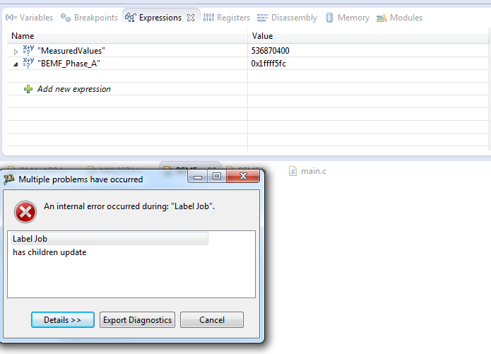

Has anyone had any luck with any of these issues? I've had them for years and there wasting a lot of time. Its a yr later. I've tried installing updates but most of them fail. I redownload and repeat the proccess as well as try on other PCs. I'm running 10.6 CW
Most annoying bug is one a previous user mentioned, not being able to expand expressions in the expression debug window. When I try to expand a "uint8_t myArray[256]" I get the following:

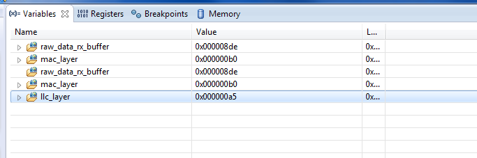

Here an example.
I downloaded a program, made some debug (I added as global variable mac_layer and raw_data_rx_buffer). I changed some lines. Compile it, download it again, start it and two copies of the global variables I had added appear. (there is llc_layer because when I stopped the program was using it).
If I open the global variables I see blank space. :smileyconfused:

BlackNight
I just had that problem of duplicated global variables too :-(.
It seems that the change in CDT is causing this (that it adds now automatically global variables). If I had added them manually before, they show up twice.
What worked for me was to use the context menu on the Variables view and using 'Remove all global variables':
this removed all the duplicated entries.
So far this worked for me (and fixes it at least for the project I used).

NicolaPonte
I'm using CW 10.5 with Win8 64 bit and I have to say that it's not possible to use it to debug (project with K60). If I want to watch an array of 256 bytes and I expand it,  in Expression View I obtain an error that says:
"Multiple problems have occurred".
The details are:
An internal error occurred during: "Label Job". org.eclipse.debug.internal.ui.views.variables.IndexedVariablePartition cannot be cast to org.eclipse.debug.core.model.IExpression
So I must use CW 10.3 (I have not installed 10.4).
Nicola Ponte
