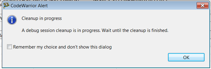

After debugging with the USB Tap when I try to debug again I get this screen - I have waited well over 10 minutes. Any idea how to disable this? I ended up closing and reopening Codewarrior 10.4 but this is far from ideal.

Try killing the "DE" (debug engine) process in your windows task manager...  I had some similar issues with CW10.2 and the TAD.

Thanks for the quick reply ! I killed the "DE" process but I still have the same issue.
