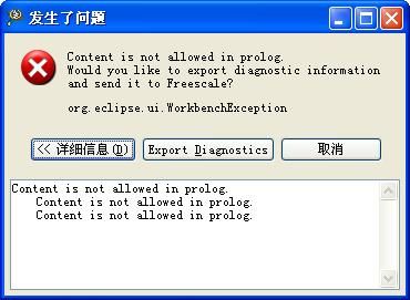

There is another error. Codewarrior 10.2 chinese edition has bug. When I make a new file or import, pop-up dialog box like this.

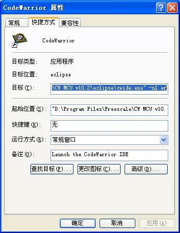

I change Codewarrior language to english by add " -nl en" on the property of Codewarrior , when I saw this post(https://community.freescale.com/thread/114388) yesterday.
Then the problem has solved.
