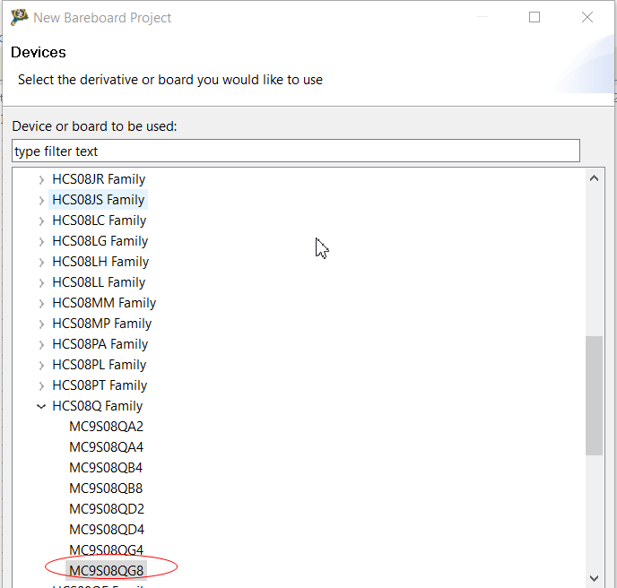

I would like to program nxp MC9S08QG8 MCU, but I have only Windows 10, 32Bit Computer.

Thank you, this point for my project Programming MCS08QG with assembler on my desk with Windows 10, x32 is realized.
With above called CodeWarrior for MCU's . . n11.1 I can progam MCS08QG.
