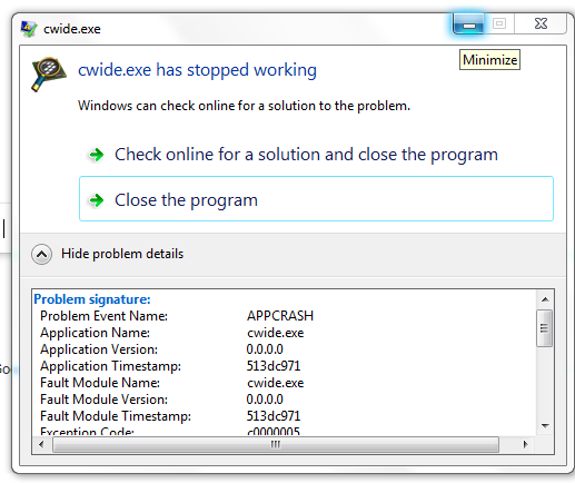

I download CodeWarrior v10.7 Offline for Windows . I install it and when I open it the following error is coming(Snap attached).
Problem signature:
Problem Event Name: APPCRASH
Application Name: cwide.exe
Application Version: 0.0.0.0
Application Timestamp: 513dc971
Fault Module Name: cwide.exe
Fault Module Version: 0.0.0.0
Fault Module Timestamp: 513dc971
Exception Code: c0000005
Exception Offset: 0000d118
OS Version: 6.1.7600.2.0.0.256.1
Locale ID: 2057
Additional Information 1: 0a9e
Additional Information 2: 0a9e372d3b4ad19135b953a78882e789
Additional Information 3: 0a9e
Additional Information 4: 0a9e372d3b4ad19135b953a78882e789
Read our privacy statement online:
http://go.microsoft.com/fwlink/?linkid=104288&clcid=0x0409
If the online privacy statement is not available, please read our privacy statement offline:
C:\Windows\system32\en-US\erofflps.txt
How can I open codewarrior? Is it required any .dll or any settings?
My system is of 32 bit.

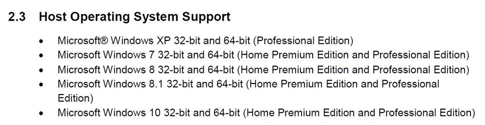

Hello ,
- Please start CW IDE as admin option.
- There is host operating system support :
-There is a same problem with yours, you  can check it :
cwide.exe has  stopped working
Hope it helps

utsavikalpesh
Contributor V
Hi Alice_Yang,
Thanks for quick reply. Yes my codewarrior is now working ok just by run exe as admin.
