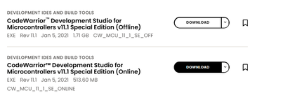

I'm downloading CodeWarrior Development Studio for Microcontrollers v11.1, but QORIVVA is not installed properly.
The installation was not successful. Section will be skipped.
If the error persists, please contact Freescale Technical Support.
This message appears during installation and appears after installation is complete
QORIVVA - Error
There wasn't any log about this.
Previously, I've downloaded other codewarriers and I'm not sure if this is a problem. I deleted them before installing.
Thank you

Have you downloaded the online or offline installer?
Offline installer does not need internet connection to install the MCU family packages.
I'd recommend you to download and install offline installer.
If both installers are causing an issue, please try to follow the steps below:
1)  uninstall/delete your previous versions of CodeWarrior you are not going to use any more.
2) reboot your computer
3) run the offline installer with administrator rights
4) choose Qorivva support in modular installer to be installed with CodeWarrior only and let other installer options default
Do you observe the same error again?

sorry for delay. What's your target MCU? If it is not MPC560xB/C/D you can ignore the error message.
