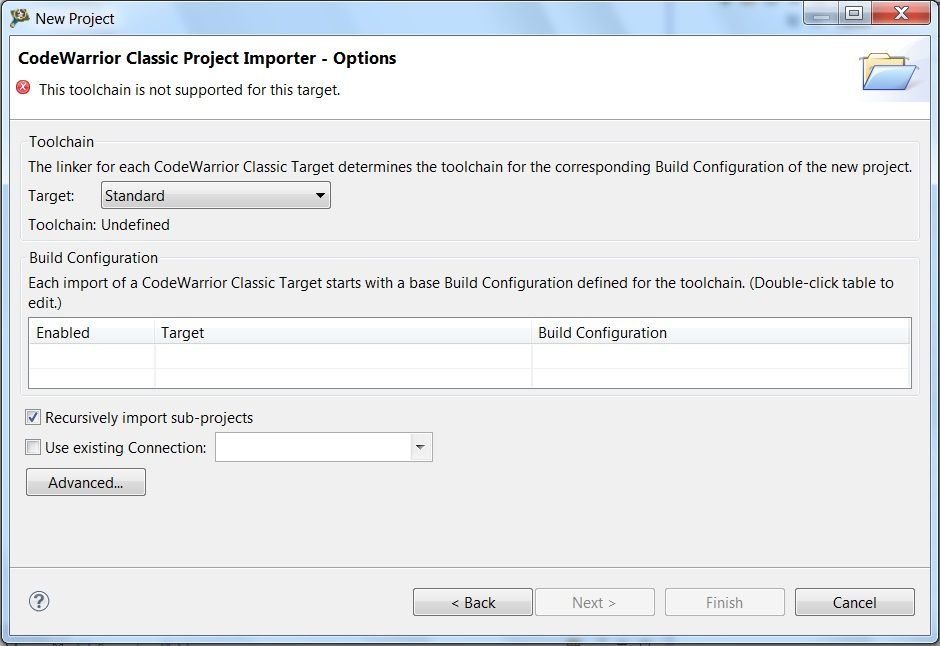

When I tried to import a CodeWarrior 6.3 project into a CodeWarrior 10.6 IDE, the "This toolchain is not supported for this target." error appear.

The Classic Project Importer in CodeWarrior 10.6 only supports DSC family.
For other products, the solution is to create a new bareboard project in CW10.6 and then add/copy all your source files to the new project. Below is an application not for how to do this:
http://cache.freescale.com/files/soft_dev_tools/doc/app_note/AN4727.pdf

Thanks TICS_Fiona . I'm very sad about this :smileycry:.

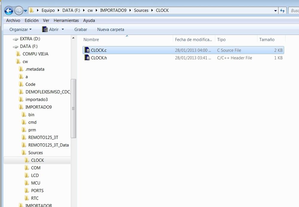

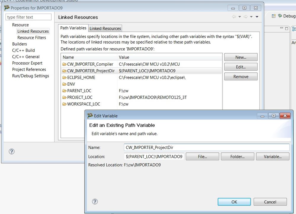

forastero
Thanks You stanislavadamek . I installed CodeWarrior 10.2 and inported a very simple project and work fine.
But when I tried to import a project with few files, it doesnt work.
I found https://community.freescale.com/community/the-embedded-beat/blog/2012/04/05/codewarrior-tip-6-there-...
But:
It doesnt work.
And the "path variables" is fine:
"Linked Resources" is fine
because the path is correct
Can you help me?:smileyconfused:
