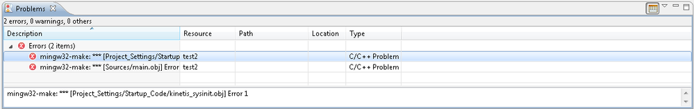

I am having this strange error. I dont have idea whats going on. I reinstalled codewarrior twice using some youtube manual step by step and also did the project that way. Any idea? Thank You.

hard to say just from the screenshot, but I would say that you do not see the full error message.
Have you looked at the Console View (which reports the full compiler messages). This should give you the root of the messages.
Hope this helps,
Erich

Source code:
* main implementation: use this 'C' sample to create your own application
#include <stdio.h>
#include "derivative.h" /* include peripheral declarations */
int main(void)
int counter = 0;
//printf("Hello (Kinetis) World in 'C' from PK40X256 derivative! \n\r");
for(;;) {
counter++;
return 0;
Error message:
**** Build of configuration PK40X256_INTERNAL_FLASH for project Linefollower2013 ****
C:\Freescale\CW MCU v10.2\gnu\bin\mingw32-make -j6 all
mingw32-make: *** [Sources/main.obj] Error 1
mingw32-make: *** Waiting for unfinished jobs....
mingw32-make: *** [Project_Settings/Startup_Code/kinetis_sysinit.obj] Error 1
9,597件の閲覧回数

what I can say is that your main.c is not the problem. Have you performed a Project > Clean first?
9,597件の閲覧回数
mareklagger
It doesnt help. This error is happening from first time I tried this codewarrior. I just wanted to start with kwikstik and I cant get over this for few days.

Maybe it has something to do with permissions? Or that your firewall/virus scanner is blocking it?
Can you run the mingw32-make from the DOS shell? For me it gives:
C:\Freescale\CW MCU v10.2\gnu\bin>mingw32-make.exe
mingw32-make.exe: *** No targets specified and no makefile found.  Stop.
Using it with the option -help shows the options.
Hope this helps,
Erich
9,597件の閲覧回数
mareklagger
For me it gives the same.
I am using comodo but it shouldnt be the case because I had switched it off during second reinstall of CW and program compilation.
