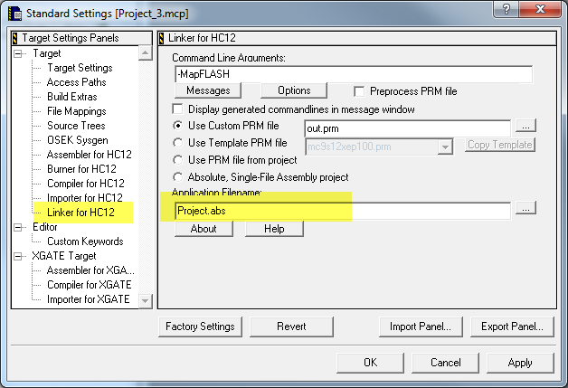

ZhangJennie
I think there are two places we need pay attention:
1. in project Linker option, please make usre the application filename is correctly defined
2. in debugger menu  "File ", "Load Application...", make sure the load file is the one that linker generated.
can this help you? if not, please upload your project here, or send it to me. I will have to check the problem directly from my side.
thanks!
Jennie Zhang
