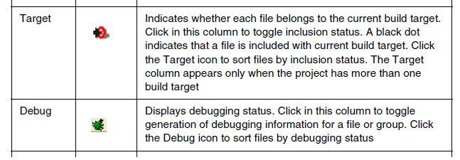

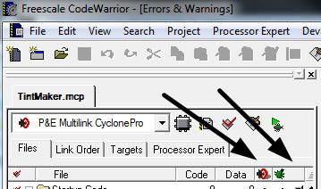

What do these two column heading in Code Warrior 5.9.0 icons mean? Some items under these heading have a dot others do not.  The rightmost icon is also on the Link Order page.
The first column with the check box, seems to indicate the source module has been edited and needs to be compiled.
Where is a CW manual which would explain this and other info?
1,438 Views
TICS_Fiona
Hello Jay
Below is extracted from the section “Projects-> Project Window ->Files Page” in IDE user manual. You can find this manual under \Help subfolder in your CodeWarrior installation directly.
