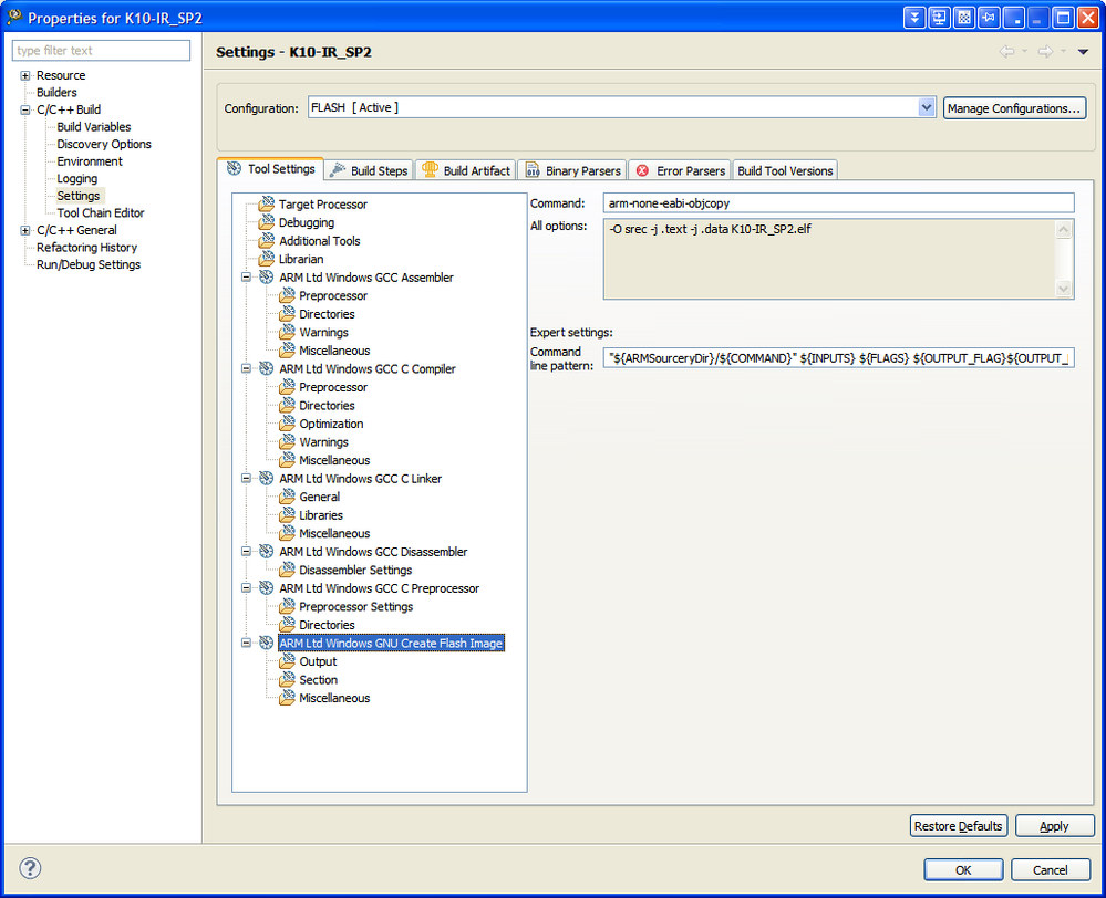

Do you think the warnings could be causing the problem?
Also, here's a screenshot of the flash image tool config. screen:
5,645 Views
BlackNight
hmm, I don't see the problem. The warning should not cause such a problem at all. Would it be possible to post your project (as zip file)? I have sent you a direct message so you could send the project to me directly (if you can do this).
Otherwise, no sure what's going on. It looks like the additional utility somehow does not get called.
5,645 Views
BlackNight
I have found the problem :-). To make a long story short. The problem was caused by custom per file/folder settings. As a result, the post build step with S19 file generation is not called.
The long story is here:
Traps and Pitfalls: No Hex/Bin/S19 File Created with GNU? | MCU on Eclipse
I hope this is useful for others who might run into that trap.
As a general advise: perform project option changes on the *project* root folder, not on files or source folders inside the project.
I hope this helps.
