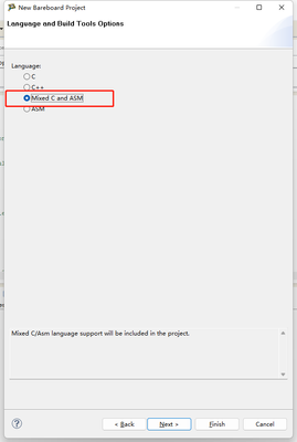

But i creat the project  mixed c and asm

Error:
creat a project in this way:so the asm code would be compiled
