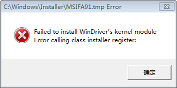

while installing code warrior V6.3 on PC (window 7, 64bit ), but failed , the remind is "failed to install windriver's kernel module code warrior"

CW6.3 is not designed for 64bit win7 platform.
if you work with HCS08 MCU, please use CW10.7 instead on 64bit win7.
