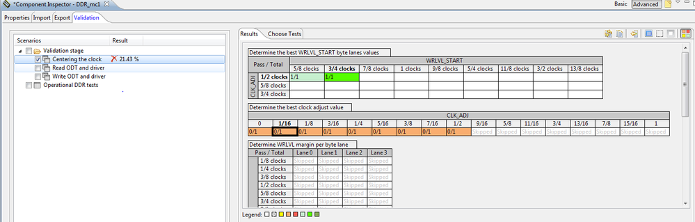

I am using T2081 and QCVS Codewarrior tool for the validation of DDR3.
While performing the test "Centring the clock" in the validation stage, I was determining the best WRLVL_START byte lane values in which 1/2 clocks of CLK_ADJ have passed for 3/4 clocks of WRLVL_START. While determining the best CLK_ADJ value in the next table as in below image it fails for all conditions including 1/2 clock .
Could anyone explain why are we facing the above issue.
Thanks in advance!
1,584 Views
ufedor
Which log corresponds to the selected cell?
