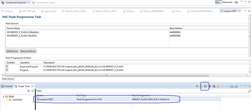

dalelee
I am trying to program a flash in MC56F84763 with the flash programmer for DSC in Codewarrior.
I added a target task to erase, program and verity.
The execute button is not highlighted for me to run the task.
How do I run a target task? I assume with the execute icon..
what would cause it from not being activated?

dalelee
Hi Fiona,
I place mouse over the execute icon, and it is still gray..
I notice when I changed Run configuration from Active Debug Context  to
WT8800-RB30_PTU_FLASH_SDM_FSL USB TAP
I was able to execute.

TICS_Fiona
Hello Dale
I’m very glad to know that you have fixed the problem, to execute the flash programming, please first select the proper connection configuration for your board.

TICS_Fiona
Hello Dale
Please place your mouse on the task name in ‘Target Tasks’, does the “Execute” turns active?
If not, could you please export your task as a *xml file and attach it in this thread? Thank you.
