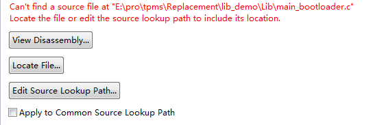

      I am using codewarrior 10.7 to generate lib file ,but i had a few problems.when i use the lib.
I download the firmware by debug,but a warning appeared
2,032 Views
xiang_zhou
Hi Erich,
   this file is not exist in the location because it is the source file that used to generate  the lib.This error occurred when I called the library.

Does that file exist in that location?
You might:
a) add that path to the source file to your path settings
b) strip of debug information if you are not interested in acessing the source file/debug information
I hope this helps,
