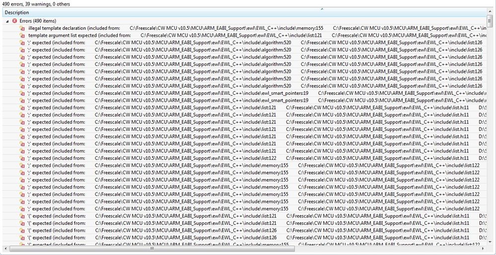

Hello All, thanks for reading.
I am porting an existing coldfire CW7.1 project to Kinetis CW10.5.
Its a big project with a lot of C & C++ files. Option of forced C++ compilation is selected.
Havent been able to build the project still. I am getting around 490 odd errors in the subfiles included from list.h, viz. algorithm, memory, etc
list.h has been included from multiple locations. If that one instant, say from manage.h is commented, the code compiles just fine with some strange warnings though ( can discuss later).
Seems strange. Any pointers as to what could be the problem?
Will I have to recompile EWL_C++ libraries?
Please let me know if any more info is required.
Edit :
One particular instance of error :
Undefined Identifier 'size_t' in file C:\Freescale\CW MCU v10.5\MCU\ARM_EABI_Support\ewl\EWL_C++\include\ewl_utility:311
included from
C:\Freescale\CW MCUv10.5\MCU\ARM_EABI_Support\ewl\EWL_C++\include\list:121 included from....<so on>
It should work since its a standard library. I think there may be an incorrect library selection problem or such. Please advise.

it looks like the problem is caused by wrong path settings.
could you please check if the library is properly included and all paths for header files are listed.
please right click the project name and then "Properties", then "C/C++ General"->"Path and Symbols" to check the paths settings.
and go "C/C++ Build" ->"Settings", "coldFire Linker"->"Input" to check if library path and library included.
