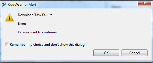

I'm trying to program a microcontroller MCF52231 wiht Codewarrior 10.5, but I'm not able to do. When I clik on the button debug, CW launch  debugger window and appears the next window.9526_9526.pngcodewarrior alert.PNG.png

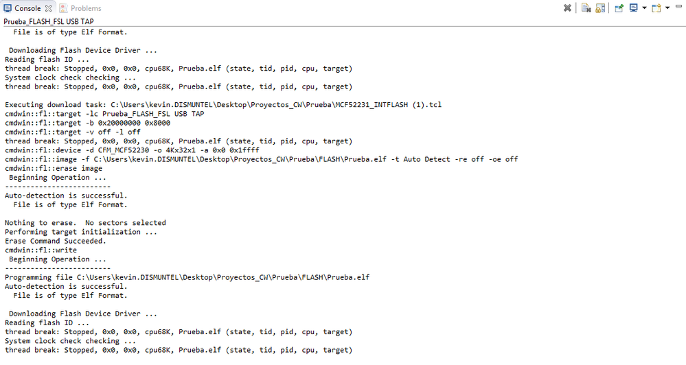

In console window, appears the next information:
Someone can help me solve this error. thanks

Hi Kevin,
Your target task could be corrupted, you can try next options:
- Create a new project which will create a new task.
- Create a new task manually, please find attached a video showing how to do this.
- Download your application using "Flash File to Target" option. You can select this option by clcking in the drop down arrow besides the blue thunder bolt icon and select "Flash File to Target" from the context menu. Then go to menu Run > Debug Configurations > Debugger tab > Download tab and disable standard download. (As the MCU will be already programmed you dont need to download the code before launching a debig sesion.)
You can find also attached a video showing 4 ways to program a Kinetis or ColdFire MCU.
Hope this helps!
