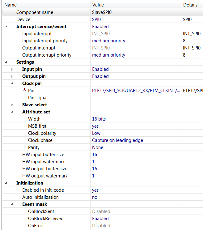

This is my SPI0 setup in PE (SPI0 is as slave):

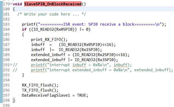

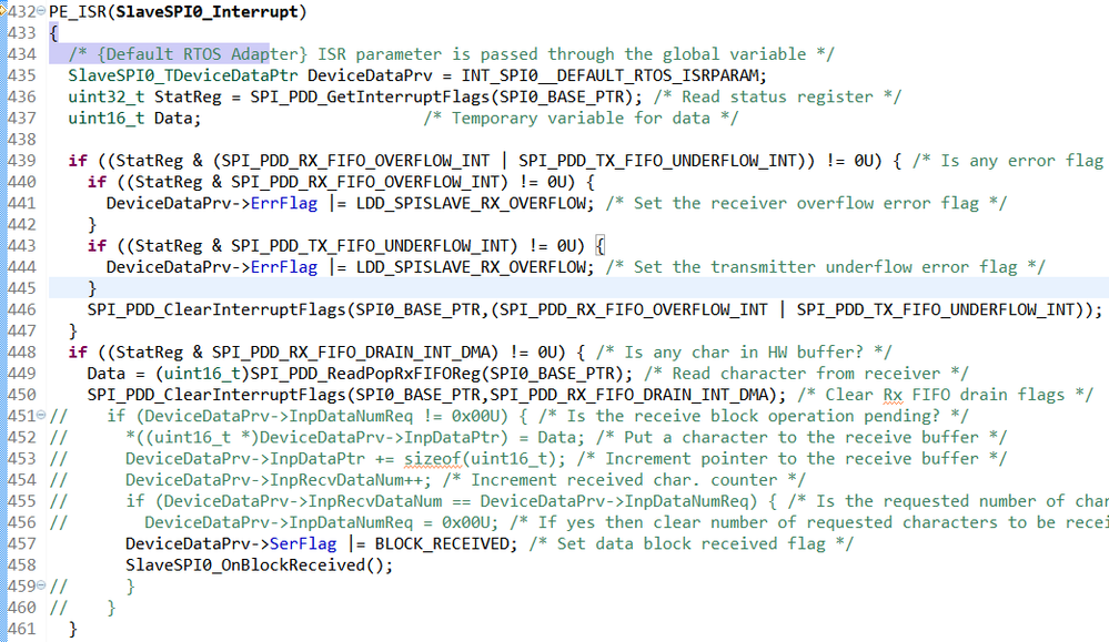

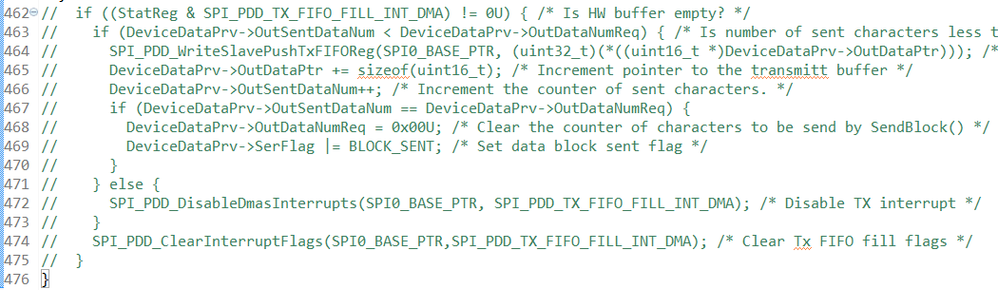

No since I did not used those SPI PE methods (SendBlock and ReceiveBlock), I created my owen in the interrupt event and also modified the ISR as below:
and also here is my onBlockReceived:
this works fine unless for the time that I receive two interrupt events for every 2 and 4 block (32bits and 64bits) sendings. I don't know why?
One possible solution I was thinking is maybe I can go back to using SendBlock and ReceiveBlock functions provided by PE and use them in onBlockReceived event method, but for that I need to know the size that I am receiving? Is there any smart way for this?
