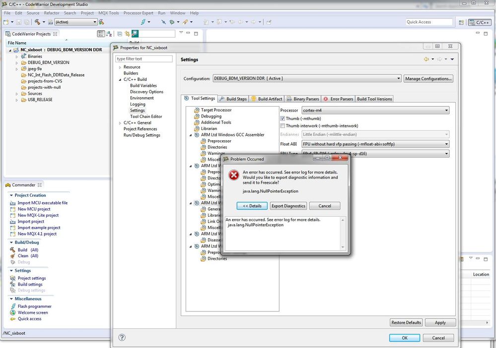

suddenly a CW 10.6.4 project I have been using for some time refuses to link and won't display the linker-general properties. a java stack error message pops up and I cannot get past it. I have tried creating a new workspace, re-installing CW 10.6.4, and even re-installing java. This problem is showing up in multiple previously good projects. It also is the same if I open the project in CW 10.6.0

I have found a work-around and no longer have any interest in pursuing this issue. I found that when the settings for the linker are checked before building the project, this error shows up. This happens every time CW is started and the work space where the project has been imported is opened. Once the project has been built during the CW session the linker settings are displayed correctly.

FANTASTIC!  Thank you for posting this simple workaround.  It works in my CW 10.6: Any time you open the CW IDE, you must attempt to build the project before viewing its Project Properties->linker settings, else a null pointer exception (java/lang) will occur.
4,678 Views
BlackNight
Ah, so this is a NPE (Null Pointer Exception) which is different from a stack overflow.
And that NPE somehow is not show in your .log.
Not sure what is causing this, but could you post your project (sources are not needed) so the engineers could have a look?

Thanks for the suggestion, but changing the java heap in cwide.ini made no difference.
Windows 7 PC. Kinetis K26 chip Below is a screen shot and below that the contents of .log

BlackNight
Hi James,
There seems to be a configuration problem with your system (maybe).
I would try to increase the Java heap available to Eclipse, see
https://mcuoneclipse.com/2015/07/31/improve-eclipse-performance-with-increased-heap-size/
