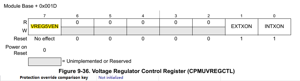

how to config VCC to 5V in Processor Expert?ZVLA128 Codewarrior 11

I couldn't find this option in the preparation.

processor expert doesn't have this option, please configure CPMUVREGCTL  register manually  in code.
