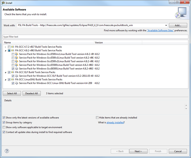

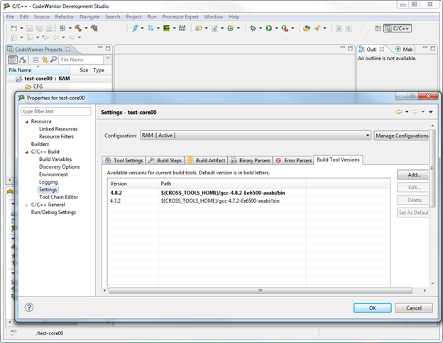

Hi Guy,
I've installed PA v10.4 last week.
I've created a default project with the project wizard.
Running the Help + Install new software I see:
Selecting the Project properties I see:

Finally, it seems it is again the gcc-4.7.2-XMe6500-linux version which
is within the pack...
Regards.

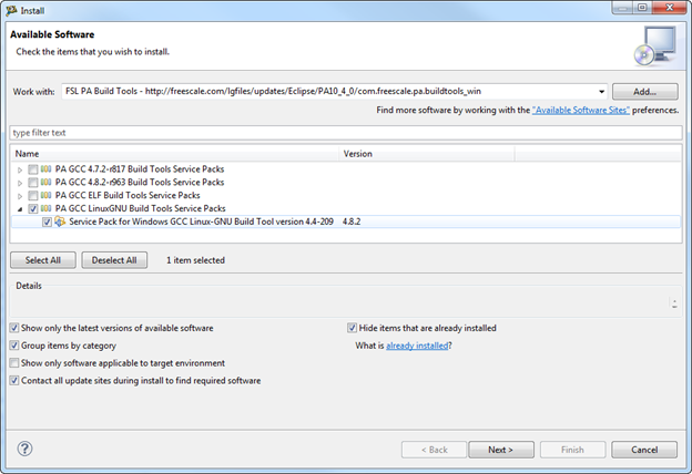

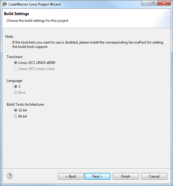

I've installed the following patches:
After that, I've created a project with the wizard:
        File + New + CodeWarrior Linux Project wizard
        Select QorIQ_T4 + T4240
now the tool chain Linux: GCC LINUX e6500 is available.
Pascal

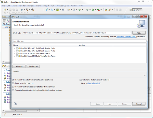

addiyi
Try to use this update site: http://freescale.com/lgfiles/updates/Eclipse/PA10_4_0/com.freescale.pa.buildtools_win. It is already available in Install New Software and will provide option for PA GCC 4.8.2-r963 toolchain to be installed.
Adrian
