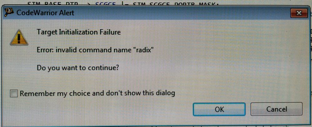

Just today I have started to receive the following dialog box when loading code on the board.
I hope that some one will tell me how to fix this problem and what is causing this problem?

For weeks, I'm getting this error
My system runs CodeWarrior 11.1. I'm using FRDM-KL25Z, with chip "Cortex M0+", debugging with openSDA.
Could you help me?
Thanks.

haroldvogel
MKL36Z256VLL4
Version 10.6
Multilink Universal
Sorry about the delay.

I use the same toolchain as yours but I can't reproduce your problem. Can you please perform below test:
1. test if this problem is a common issue for all project or for a specific project: create a new project with wizard, does this new problem have error as you described?
if this problem is only for one specific project, please send this project to me, I will check it directly from my side.
2. to test if this problem is associated with a specific workspace: create a new workspace folder, test if the problem persists?
if both 1, and 2 can not get rid of the error, I suggest you use install CW10.7 and try project with CW10.7 instead.  CW10.7 is our latest CW version that fixes many defects of 10.6. here is CW10.7 download:
CodeWarrior for Microcontrollers-Eclipse IDE|NXP
Can CW10.7 solve your problem?

Hello Jennie,
The problem is one that comes and goes. It will appear and cause me some problems for a period of time and then go away and not appear again for some time.
If I get the time from the project that I am on I will run your tests. Currently the problem has gone away.

to solve your problem, we need to know:
1. what chip do you work with?
2. what's your CW version?
3. what debug interface do you work with?
thanks!
