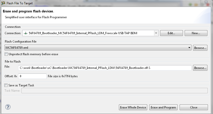

I tried to work with the "DCS Flasher" using the GUI ,but I am getting an error which I am not getting using CodeWarrior  .
Using the "DCS Flasher"  I Do a Program/Verify I get the following message :
Performing PROGRAM operation on MC56F84789 through the UTAP . . .
Error 1: Unaligned srecord at C:/work/Bootloader/uC/Bootloader/MC56F84789_Internal_PFlash_LDM/56F84789_Bootloader.elf.S:271: "S30B0001F3FDCDAB3412FF0046" .
But when I am using the Flash operation using the Codewarrior  I do not get any Error , please see the following :

Please advise if you have a solution as I need to give our production line an easy tool for programming ( via command line ...batch ...)

56800E Flash Programmer does not support MC56F84789.
To program MC56F84789, user can use CodeWarrior for MCU10.6.4's built in flash programmer. CodeWarrior v10.6.4 can be downloaded from
http://tinyurl.com/6jo5tge
Or choose P&E's Cyclone MAX:
http://www.pemicro.com/products/product_viewDetails.cfm?product_id=145
Or you can use DSC Flasher to program 56F84789. Please search 'AN4824' on NXP website (www.nxp.com) to download this tool and help document.  It is a free tool.
