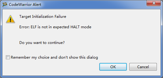

Using Code Warrior 10.5 to connect the P1010, but failed.
Error : ELF is not in expected HALT mode
I use "P1010RDB_init_sram.tcl" to Initize P1010.
I need help, thanks.
following is "P1010RDB_init_sram.tcl"

Probably there is JTAG hardware design problem on your target board, please refer to page 6 in the attached ppt to check the hardware design, especially HRESET and TRST signals.
If your problem remains, please refer to the following procedure to capture your CCS log to me to do more investigation.
Please enable CCS log from "Run->Debug Configurations -><project>-core0_RAM_-Connect(Download)->Edit...->Advanced->Advanced CCS setting->Enable logging", and connect to the target from "Run->Debug Configurations-><project>-core0_RAM_-Connect(Download)->Debug”, the CCS log will be displayed in the console panel in CodeWarrior IDE. If you didn't find anything in the console, please open the panel from Window->Show View->Console, if the CCS log in the console is truncated, please enlarge the console buffer from Window->Preferences->Run/Debug->Console->uncheck "Limit console output".
Yiping
