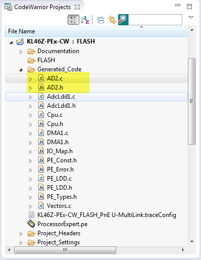

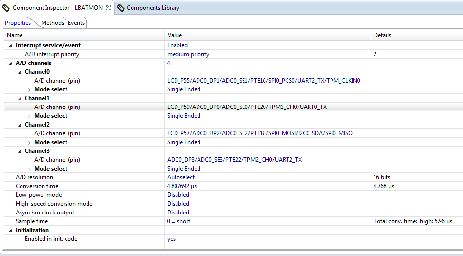

I have an existing project and I am trying to add two more lines to the A/D Channels
I have added the lines and would like to know how or if the Generated Code has been updated and where the code is located?  Would also like to know how I can associate the Generated code with the items in this view?

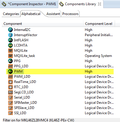

Need to also add some new GPIO lines to send a modulated pulse out on and would like to know how to set them up?

The generated code for the component is located inside the folder named Generated_Code, the files are named the same as the component:

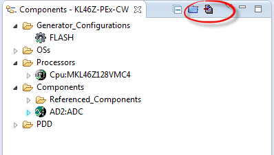

About the code being updated, just make sure to click on the "Generate Processor Expert Code" button each time you make any modification to the component properties, methods or events:
Regarding your question on how to set GPIO lines to send a modulated pulse, you could use the PWM component:
You just need to configure the period, starting pulse width and set on which pin you want the output.
